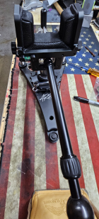

Hello all, ever since I launched the AR250 many people have been asking for an adjustable top especially for those who shoot with various non standard stock sizes (other than 3" and 2.25"). This is a late Christmas present but I am happy to announce this new adjustable top plate design. This adjustable top plate uses a 3pcs bag system with a center front bag and 2 bags on the sides which will give 100% contact with the rifle stock no matter the width. The compact design of the side plates is possible due to a different locking mechanism than most side plates out there since they clamp outward onto the top plate from the inside of the groove channel.
This top plate can be purchased as a standalone upgrade for $149 (only comes with the top plate, 2 side plates, and 3pcs bag. Stopper, bubble, and side screws are not included). I will also include an option to upgrade the AR250 from the standard 1pc bag top plate into the adjustable top plate. New AR250 with the adjustable top plate will cost $735. But I can only offer this upgrade once I have actually finished this first batch of adjustable top.

I decided to use the case I was using for the Shadetree and to my surprise I had very little alterations once I decided how to place it in there. I 3d printed a few clips to hold the handle and some feet to set the rest into to eliminate movement. I even had plenty of room for my rear bag.
Isn't professional looking but it is functional. The foam on the lid helps secure the rest and bag.
I decided also to rotate and shoot the rest with the single leg facing target. Seems to be very steady in this position.

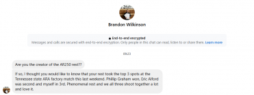

Biggest congratulations for Brandon Wilkinson, Eric Alford, and Philip Graham for winning the Tennessee State ARA Factory Class Tournament! For not just one but all of the top three spots to be using the AR250 rest is a first since I launched the rest. The three of them are shooting buddies and each will receive a free adjustable top plate upgrade which would allow various stock width between 1" - 3", suitable for ARA factory classes. Keep up the good work guys
