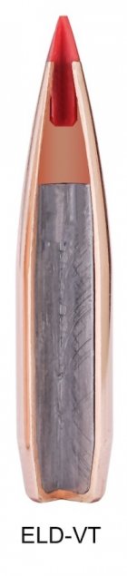

As I understand it, these bullets should have approximately the same external dimensions as the comparable version ELD-M bullet, but the weight of the ELD-VT bullet will be slightly less due to a shorter/smaller lead core:
If so, these bullets should enjoy reasonably good BCs, but not quite as high as the comparable ELD-M bullet due to the lesser weight.
The real questions in my mind will be how well the jackets hold up and what effect changing the center of gravity (CG) might have on precision. Some manufacturers use heavier jackets for target bullets, and with good reason. Some of the Hornady ELD-M bullets have already developed a reputation for being prone to jacket failure, so hopefully the jackets of these VT bullets will be better, although I doubt it. The CG issue is what it is, we will find out soon enough. I have become a big proponent of the .224" ELD-M bullets, and I wish Hornady success with this endeavor. I don't really view these VT bullets as viable "match" bullets for most shooters, as the ELD-Ms would be the better choice for use solely in competition. However, they may find a niche for those that wish to compete and hunt with the same rifle. An F-TR rig chambered in .223 Rem or .308 Win pulling double duty as a hunting and competition rifle would be one example of how that might work.
