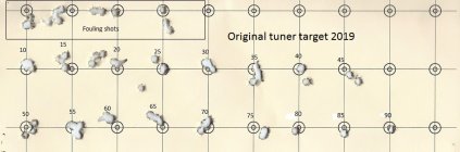

I am sure as you were trying to tune the rifle you saw shots that migrated around the POA to POI as you made tuner setting changes. the setting you want will place the POA to PPI at or above your POA.
This example shows how shots migrated around the center of the bull which was the POA and how tuner adjustments changed the POI. the final setting for this rifle a factory Anschutz 54 was set at 90 and has not been changed since this was in 2019. groups were 3-shots, and you will notice that between 80-90 settings the groups look identical however 85 is below the horizontal line and 80 is left of the POA setting 90 is just at the horizontal line and right of center. remember right-hand twist barrel so shots will naturally go right if bullet exit is correct. use 5 clicks to make each adjustment as you shoot, I use only 3 shots as it lessens any chance of a skewed shot from condition changes.

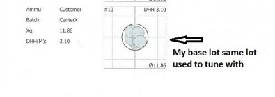

Some examples of why you want a setting that will put shots at or above the horizontal line-
The IBS target was shot at 100yds. notice the number 2 bull that is 3 shots, the wind was rather strong that day, so we elected to shoot the same target for 3 relays. each shot was 7-minuts apart. lastly Lapua tunnel test results same tuner setting of 90 11.86mm 10-shot group.
Lee
Lee
