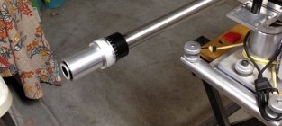

I lighten them to give the barrel the best chance to reach the maximum height of the movement before the bullet exits the barrel. I found by doing this I broaden the window of different box lot speeds that will shoot same POA/POI
I did an impromptu test and using the same rifle tuned it with a standard weight Harrell's and then with a lightened weight difference was about 4-oz. this was done on the same day using the same lot of CX.
my tuning approach is based on how an iR50/50 sporter rifle can shoot as good as a rifle with adjustable tuner without any adjustments once weight is determined that is needed at the end of the barrel.
Lee
