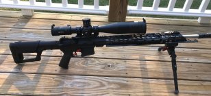

I got one to try out and still playing with it. I put it on my 6mm ARC. I have my Arken showing up next Wednesday so will do a head to head and see.
