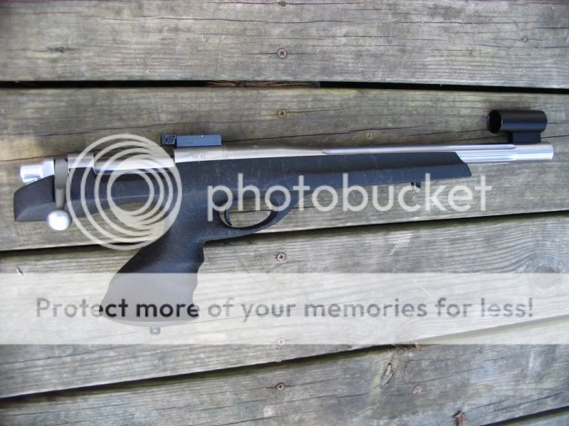

GaryD,
I have been very happy with mine since early 2005. Great application using a left hand bolt and left hand port for a right handed IHMSA silhouette pistol. This one has a Dewey trigger and muzzle break, H-S Precision stock, Bomar rear with Bond front sight, and Lilja barrel chambered in 6.5 Grendel.
DougF
GaryD, I have several XP's and they are great actions, but finding one in top condition is getting very hard to do and when you do it still needs to be trued, a bolt release installed and bolt work. I ended up with more money in the thing then if you'd have just purchased a custom action to start with. I love my XP's but if I had it to do over I'd go with a custom action.
Good luck with your build.
RJ

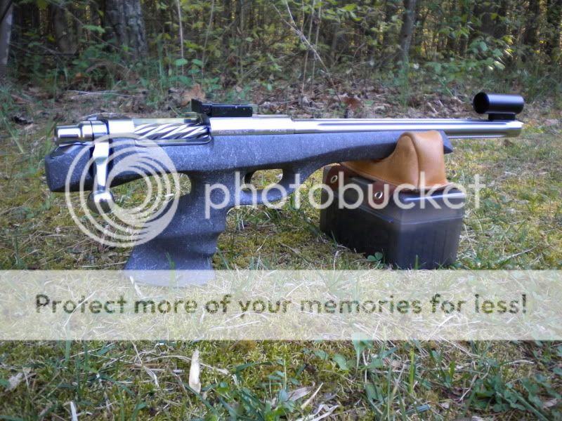

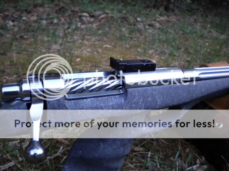

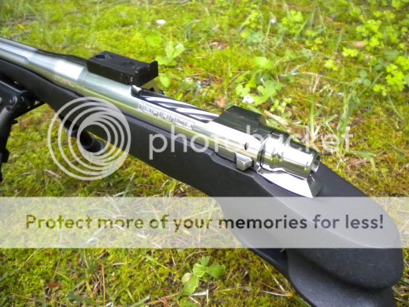

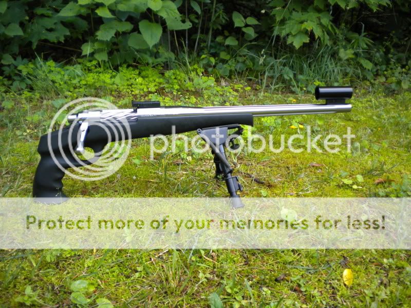

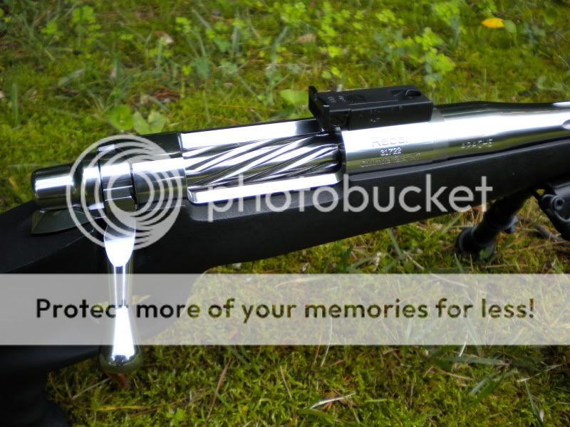

I do a fair amount of custom XP-100 builds for IHMSA competition and hunting and currently have my 4th Defiance project going. Here are a few pics of some of the Defiance's. Thanks, SR
This one is a rear grip Defiance in 7BR for IHMSA Unlimited competition. Krieger fluted barrel, rear grip HS stock.
This one is in 6.5 Grendel, Kreiger custom contour barrel, HS center grip silhouette style stock.
This one is also in 6.5 Grendel but is actually a Phoenix action. This was the first XP footprint action Glenn did under the Phoenix name. This was before he started doing his own bolts and this one uses a PTG bolt. Krieger barrel, HS center grip Varmint stock.
