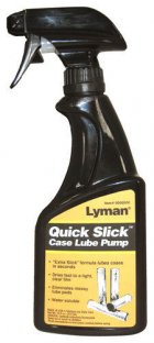

I use this because it is not in an aerosol can and use it in the same manner.
