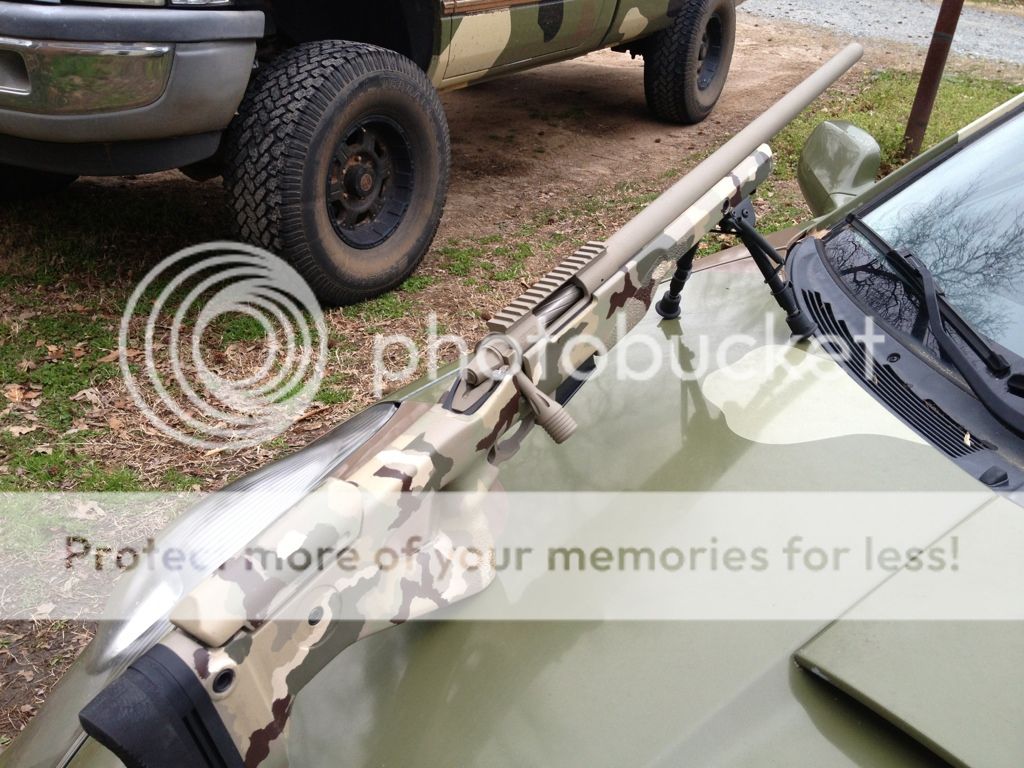

Mine is based on a Surgeon action with a Krieger barrel and Jewell trigger built by Terry Cross. Has Terry's KMW Sentinel stock made for him by McMillan . Topped off with an S&B 5-25. It has lived it's life as a .308 for the last year and I've learned a lot about wind reading. Monday my new barrel in 6.5x47 will be here from Terry and will be changed out. The .308 will probably not go back on it for a while. I really like the 6.5x47 round and prefer the small primer. The great thing about having one from Terry is that he keeps all dimensions per serial number pertinent to chambering and when you want a new barrel you can shoot your old one until the new one arrives. He only builds an extra rifle every so often with an agency order so getting one from him can take a while. That said I could not be happier with the rifle.
