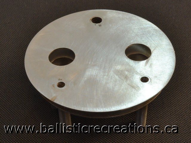

I have the rcbs concentricty gauge PITA. Going to be building one using 608ZZ bearings, 8mm (5/16) drill rod, 8mm O-rings,1/2x3” Cold Rolled steel and 8mm dowel pins(when i have free time). This is basic machining you’ll only need a drill press, a welder(for tacking), 8mm chucking reamer and some time. I could go on and on about this subject.
