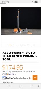

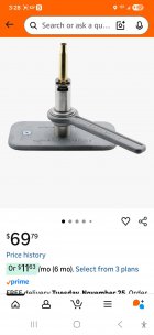

I started with the RCBS hand primer then a year later Frankford hand primer, which is very accurate. However, I'm done squeezing. I just bought the Lyman Accu-Prime, I was getting the Auto-Load but there seems to be a problem getting the primer to recess in the primer pocket. However the base model is very accurate and inexpensive.
