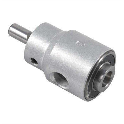

You may want to call and ask. They also recommend getting the carbide arbor if your turning a lot, Keeps the heat down. I talked with them the other day. But on their website, if you click the different turners links on their site, I think they list what calibers and what angles are for what.
