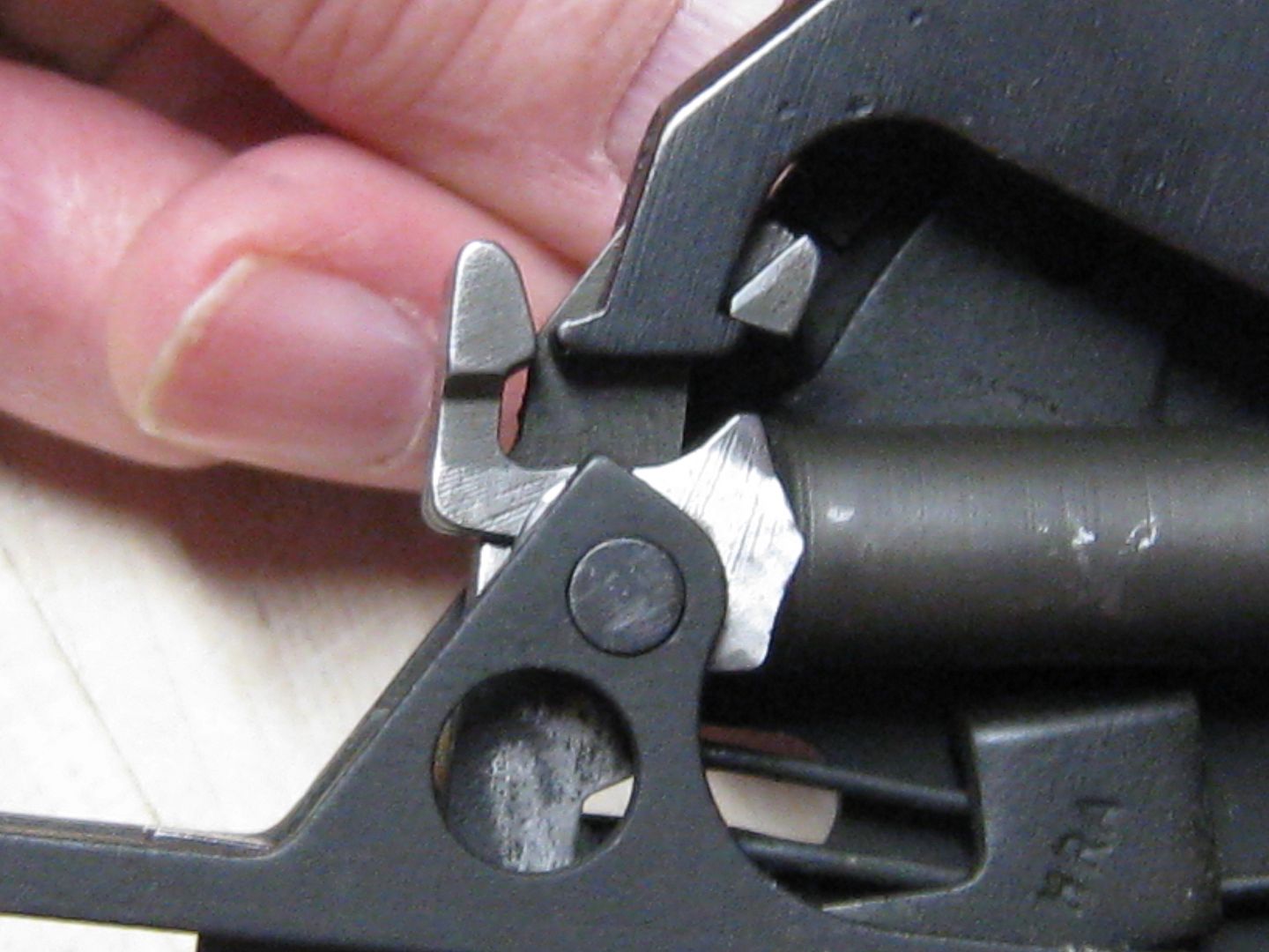

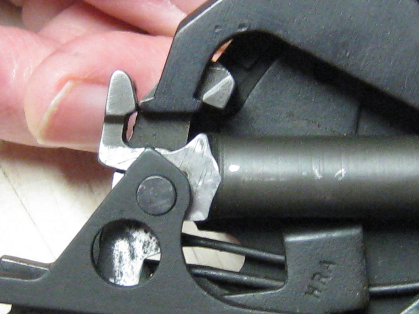

BTW........ Close examination of the trigger group shows a positive lock up and plenty of hammer/sear contact before release. The trigger seems to be a 4.5 pull.
Makers Medallion.
Stage one.
Stage two.

Latigo,
Mac adjusts his triggers to the absolute minimum sear engagement, with most of the weight in the first stage. I was sure that mine would double, but it doesn't. It has been very, very dependable. But mine is single lugged only at the back. (I went and dug my triple lugged rifle out of the safe a while back ... it was built be Clint Fowler, and the forward lugs are slightly different and located more forward).
These rifles are meant to be fired with the buttplate HARD into your shoulder, even in offhand where you can't use the sling. If you use a "soft" hold as in benchrest shooting, you are probably bump-firing it. The combination of the way the rifle recoils, and the trigger technique ("milking the trigger") will make it double, or even simulate full auto fire. I can do this on purpose, it gets folks attention with an M1A and ten rounds in the magazine. (if you are using your mechanical rest, you may get the same efect)
I would fire it in a good solid prone postition with a tight sling. If you want the security of a rest for ammo testing, put a sandbag under your gloved hand. If it still doubles, do the same with M72-equivalent 173 or 175 grain loads. If it still doubles, it needs some attention. The Easy Button would be a new hammer tuned for a bit more sear engagement. If all this doesn't work, then you need to talk the The Master himself. The "unkown" to me is how Mac's forward lug system may effect the way the rifle flexes under recoil forces, and how that may effect the minimum tolerable sear engagement.
Hope this helps ...
