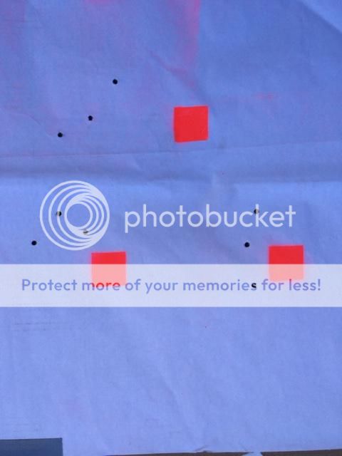

Went out today to my buddies work and did some testing. Put up wind flags, and was a steady light breeze of 2mph going left to right. Target was set at 385 yards. All shots felt great great. My fouling shots were the best on , go figure!
Three shot groups.Just want see whats it's doing. I'm just going to load the .003" load and go have fun. Just wanted to share my results. BTW parallax is good.Thanks for all the tips.
Top Left : .004" neck tension / Speed 3122, 3018, 3122 / Group 3.75"
Top Right: .003" neck tension / " 3122, 3122, 3129 / Group 2.75"
Middle: .002" neck tension. " 3086, 3122,3129 / Group 3.75"
Trail, the .003 neck tension triangle looks good. Should tighten up to sub-1" with seating depth test. Don't wimp out now, dude. Seymour

Curious, what was the neck tension of the fouling shots that went the best?
