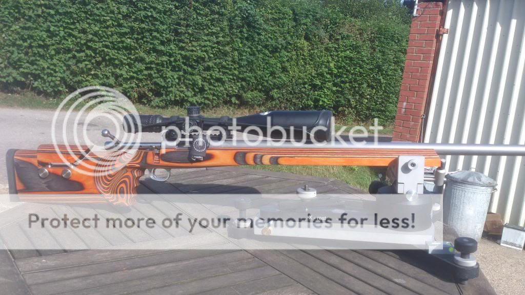

Some info on the rifle. It started life as a std Howa1500 but last year I had a Bartlin 32" barrel put on it, the action was also checked. It has a Jo West stock thats bedded.
