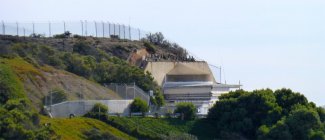

Here are images from John Stanton of Fort Rosecrans, Battery Ashburn on Point Loma, in San Diego, California. Notice the inviting fence around one of the entrances and the seaward facing portion of the facility.
