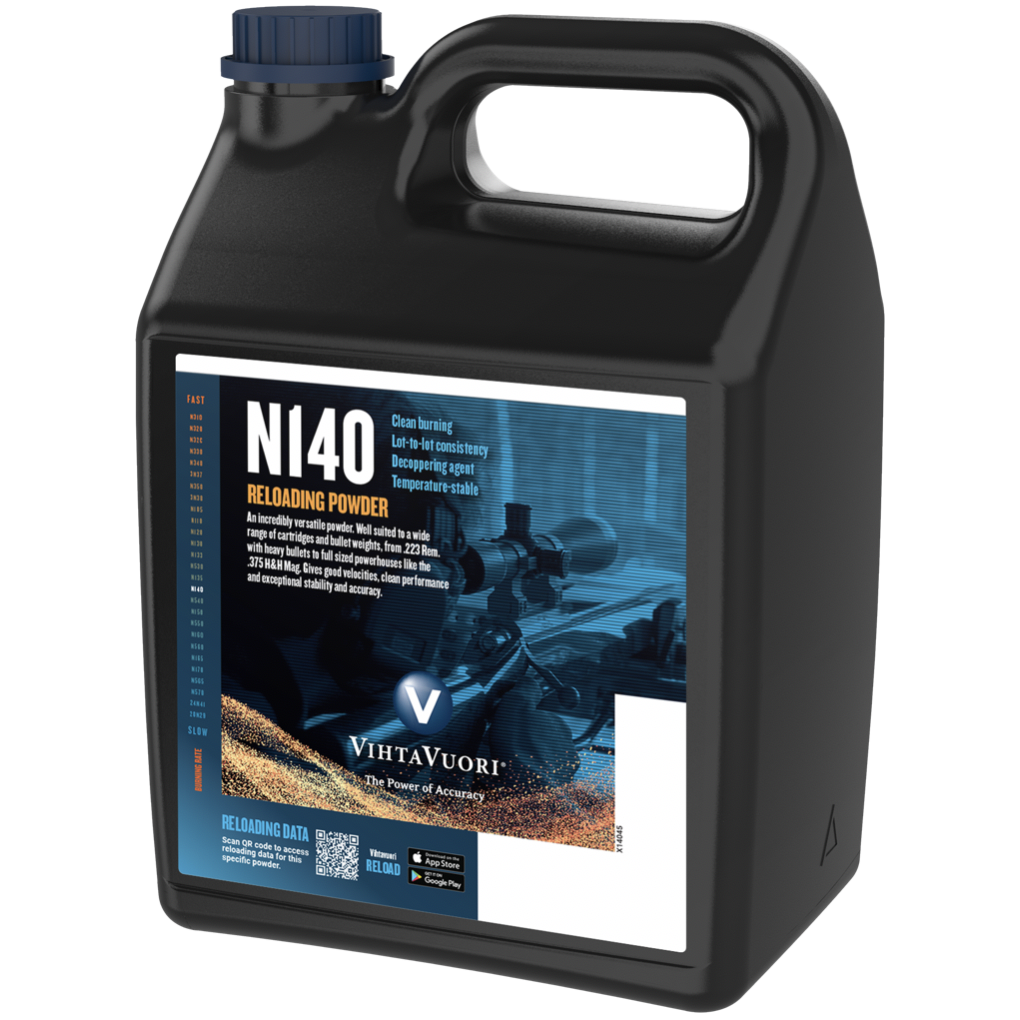

N140
31.5 in a BRA under a 105 hybrid. Barrel finally gave up the ghost after this relay… about 2500 rounds. Case fill is a meme. My rounds sound like maracas.
Edit: this is in a BRA. Your load will be lower. As always, start low and go slow so you don’t blow your face off.

best accuracy so far was 31.32 gr N140 (2014 lot) = 2954 fps
at sea level
