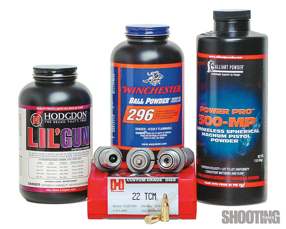

NOE has a new powder through funnel that goes inside the Lee rifle powder die. They work great, especially with small calibers like .223. The TCM powder is very small grained, so flows easily through the NOE funnel. I have the Hornady 3 die set that includes the expander die, but the latest set only has the sizer/decap and seating dies.
AA2230 works good in the my 20 MGM wildcat so it shouldn't be any problem in the 22 TCM. We're only talking 10+ or - grains. Work it!! ;)

Or Hornady's seater has a sleeve that slides down over the bullet and neck.of the case to keep it aligned. They make a dedicated 22 TCM die set.
