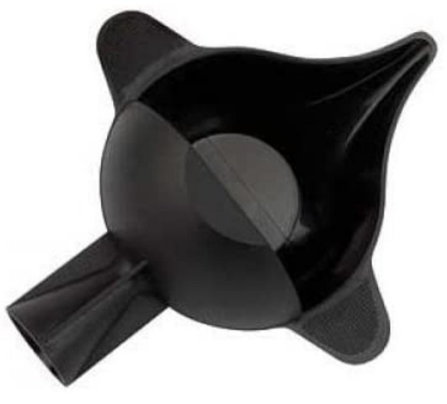

1st off being aluminum / pot metal, no static charge forms and the powder kernel's go right down the funnel into the case with no hang up.
Also the funnel comes with interchangeable case neck dimension inserts so you get no powder loss outside the case neck.
And who makes these?
Thanks
