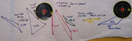

I went out with all my reloading equipment and worked up some data for the new TS15.5 powder from Alliant. You can see my rough powder ladder below:
I want to caution anyone thinking of trying this that I'm just a random guy on the internet and you can't assume this is safe. Based on speed alone, we all know there is a lot of pressure to those top loads.
Based on this ladder, I loaded up some 3 shot groups to see where a node might be at. Wind was switchy and I think that blew up the groups and also resulted in my top green group blowing over into my 22BR groups on the right. Pencil marks show the middle of the groups. Also note that I shot my Peterson brass and my Lapua brass which have very similar volumes and saw vastly similar performance.
I think 38.2-38.4 might be a node, but I'll need to repeat this to know. There is a lot of vertical present in these groups.
600yards again today. Cool humid and mildly windy.
My node of 38.2 to 38.4 seems to be holding. I'm not seeing much that excites me. I think I need to make some larger moves on seating depth. These are all jammed a good ways and maybe I will find something good a bit further from the lands.

Conditions were challenging today with gusty wind and 100 degree heat.
The seating depth test on the right seems to suggest that I have a 0.002 or so wide window between 3.181 and 3.179 (about 0.004 to 0.006 out of the lands). It looks like my ladder today solidified the node too. ~2930fps and 38.2 up to 38.5gns is flat, although 38.5 is the maximum in this gun. It had stiff bolt lift and was leaving unhealthy smears of brass on the bolt face.
