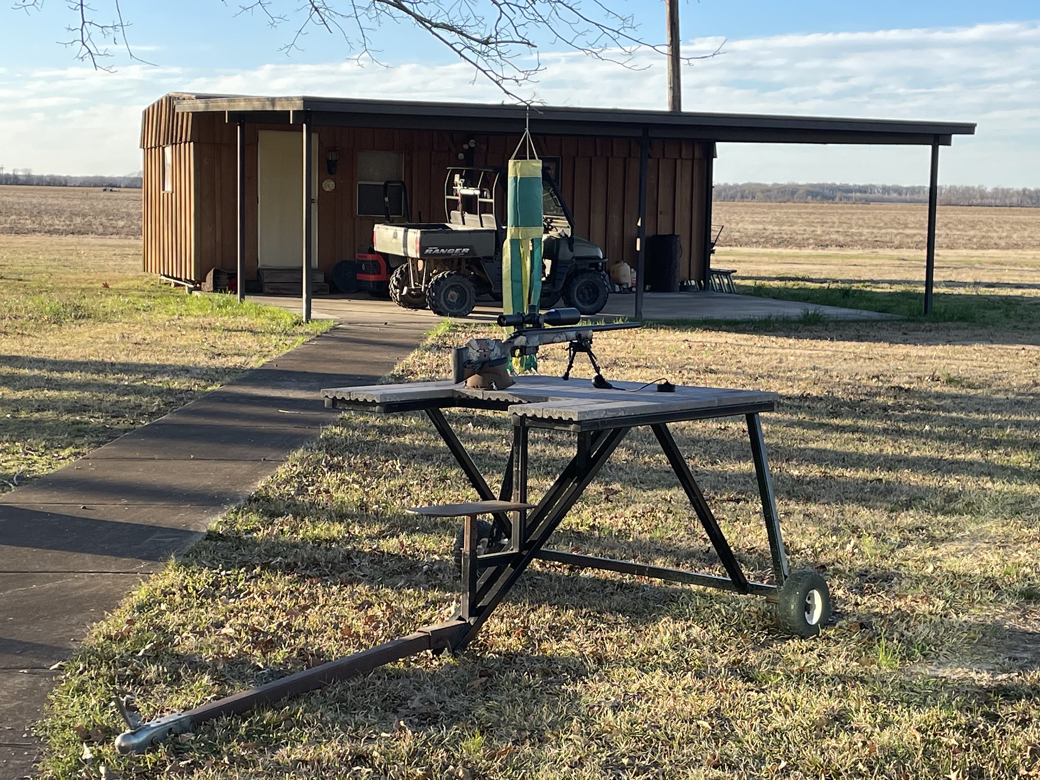

I appreciate that, but my choices are limited at the moment. I've thought about building a different bench that may be more stable, but this one is pretty close to the limit of what I can physically handle moving in and out of my truck. For now, it's just a part of the equation and a small excuse anytime I didn't shoot as good as I had hoped to, haha.
I'm wrestling with the same dilemma on the weight / size / ease of maneuvering a portable bench while making it BR stable.
