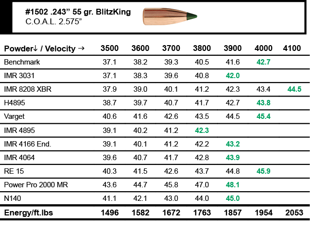

Here's a sample page from a reloading manual:
Above gives the bullet type, overall length of cartridge, type and quantity of powder. The manual will also tell you what primer. 11 different powder types (above) and dozens of different powder quantites give you endless parameters to "dial in" your load.

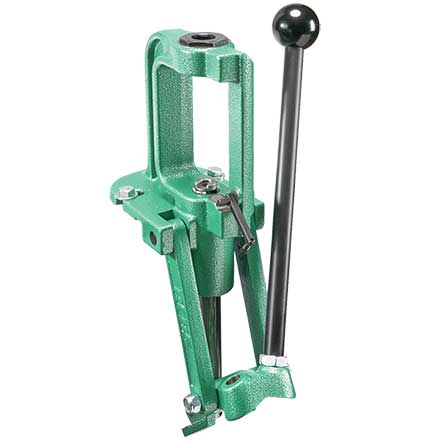

3. Get an RCBS "Rockchucker" - but only for re-sizing your cases. Its a single stage press that's very easy to learn to use well and will last you for years.
You will also need a sizing die. RCBS, Lee, Dillon, Forster, etc have these. For initially getting into reloading, most any of these will do. Yes, accuracy can be improved by type of sizing die and its setup, but that's for down the road.
4. Measuring powder is main critical safety component. There are others, but this is the main one. In the table above for .243 rounds, you'll see Benchmark powder (listed first - 37.1, 38.2, etc ) with coresponding velocities. Start at the low end and work up in small increments. Likely the most accurate load will be in between the listed powder quantities. . The table also shows listed velocities, but what happens on paper with group size is the most significant measurement you are looking for. (When you start chronographing velocities, standard deviation and extreme spread will be important also, for your grou size over distance.) ) HOW you measure powder has numerous answers, and Youtube can give you lots of info there - here is but one video:
