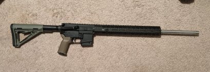

My first 223 PD AR shooter feast eyes

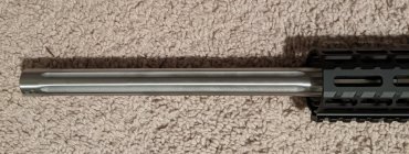

All my good shooting guns are bolts but never really tried to see what an AR could do with a better barrel. Found a 24" bull barrel in stock, did not want fluting but its only on the end not the first 3/4 of barrel. Actually the weight reduction is where you want it at the end of the barrel.
For $400.00 got a barrel, Aero gas block, tube, pin, extra bolt, some bore paste (has to do with break in)
Used spare parts laying around the house. Mated the barrel with a different kind of upper. One that does not have a typical barrel nut with threads on the inside. The threads are on the outside of the nut and they use like monolithic upper that seems to be beefier than a standard AR upper. I think its to isolate the hand guard from the barrel nut.
I've not torqued the barrel all the way (could not find my 3/8 to 1/2" adapter for the wrench.) Do these heavy barrels need any more then any other AR? 40 FT pounds good?
It went together very easy. I was worried the barrel might not clear the barrel nut. No issues there and the M4 feed ramps lined up perfectly. Barrel slid into the upper without any struggle not loose but not where you have to pound it in.
Its not nearly as heavy as I thought it would be. The balance point is going to be right under the scrope near where the barrel connects.

Shows how the upper and proprietary barrel nut fit.
Wont be using that lower might put a A2 stock on it and need a bi pod.
