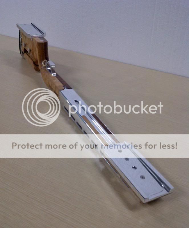

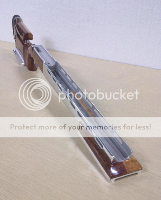

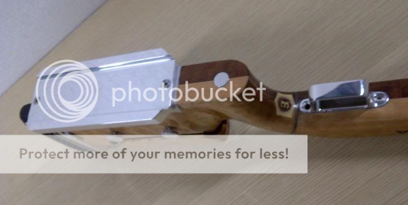

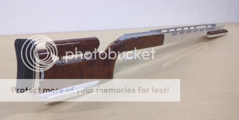

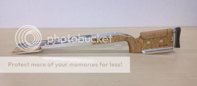

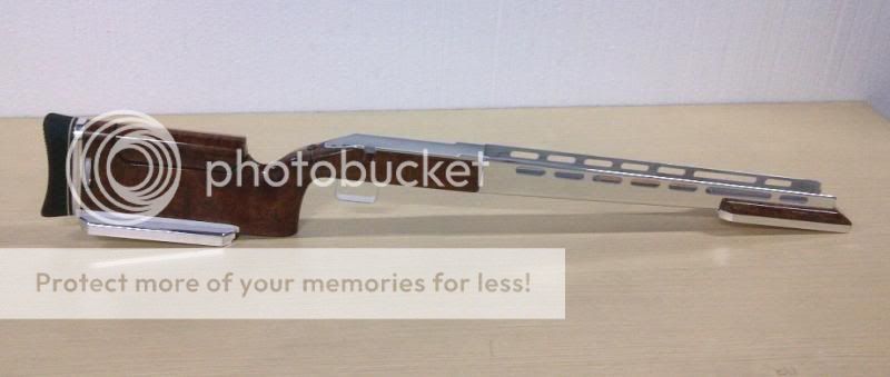

First, I prefer to make / use my own stuffs ;D -- this is my attempt..... :D
#2. The stock must be no more than 3.6 lbs to make weight for F/TR. My F/TR barrel is in heavy side, approx. 8.6 lbs.
Both stocks are not finished, yet.
The one with alumunium foreend currently weighs approx 1.6 kgs (3.52 lbs), with integral rail on the forearm. It's for my brother (Ernie Bishop). It will make F/O weight without any problem even with additional 3" foreend attachment (not shown in the photos), Etc.
The right hand side of the buttstock is 'brown' (local wood), the left hand side is 'yellow" (maple). Hollow + carbon fiber inside.
I was thinking to make adjustable & removeable buttstock before, but ended up with 'this' one. No much time left!
If I make adjustable cheek-piece it will take more time, so I'll probably make a 'clip on" (raised) cheekpiece if Ernie needs it.
Actually the wooden buttstock can be removed/ removeable (secured by a screw only from the bottom of the hand grip)- but I'll probably epoxy glue it.
The 'conventional' one weights approx. 1.55 kgs (3.4 lbs).

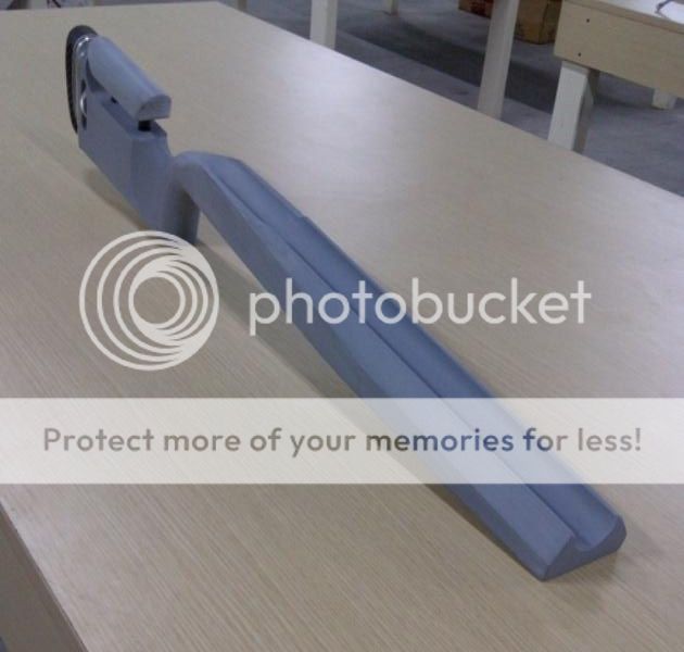

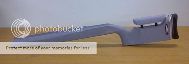

It is made from several layers of lightweight plywood + carbon fiber - for rigidity.
(I was also thinking to make two identical stocks for Ernie & me, but no much time left now).
This one (2nd stock, still in grey epoxy filler) is much quicker & easier to make. I'll use it for the F/TR Nats & Worlds. I'll just paint it.
Both have 1.75" buttstock - I'll make custom rear bags for them.
Both are 'low profile' stocks, and ambidextrous. Ernie is a leftie, I'm right handed. We have the same actions & barrels so we could interchange stocks in future use.
While adjustable cheek piece is not important (for me), adjustable height recoil pad is 'a must', even it adds about 12 oz to the stock! Currently I only have the thick Pachmayr's recoil pads, so be it....probably good for the heavy bullets we will use. ;D
Yes they are rigid & strong if you are wondering about it.
The recoil pad is removeable - to reduce the total length a bit (by approx 2") --- in case they don't fit in a rifle case. (Or.we can store the rifles with barrels removed).
I might add spacer for Ernie. He is a tall guy, lol.
I'll take some pore pics in the next few days. Still plenty of works, only three weeks left!
Suggestions / inputs?
Cheers,
seb.

I did make an adjustable cheek piece to the stock with alum forearm today, on Ernie's request. It was cut from the current buttstock. It adds approx. 4 oz to the stock weight. --- It will be difficult to make weight for F/TR in the future, unless a lightweight scope is used (such as a fix power 40X/50X), or a barrel no more than 8.3 lbs such as the heavy palma contour.
But for F/O, his stock can be as heavy as 6 lbs! So no problem at all.
Will apply carbon fiber (wrap around) to the conventional stock tomorrow.
I changed my mind to just paint this stock - I reduced the weight by approx. 10 oz today. It will be no more than 3.4 lbs when finished, will be more stronger anyway.
seb.

Well, finally our stocks are "ready".... I shipped them out today, should be arrived on Thursday/Friday.
It was rush time, not the best I can do. But at least it looks different, lol.
According to my past experience, the stocks would/should track & balance just fine. My fingers crossed. :)
seb.

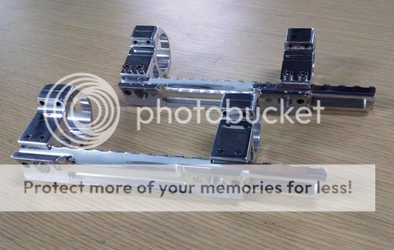

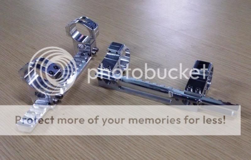

I refuse to use aftermarket bases & rings, this is my attempt....
They weight approx 6.15 oz per set. Base are 25 MOA.
