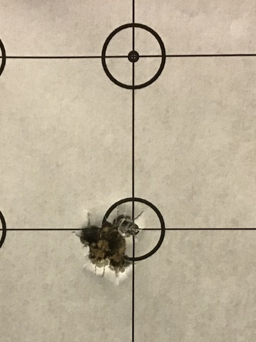

I recently got one of the old 26" Rem. 700 VLS in 260, scoped it, threw some rounds together (Hornady brass, 250 primers,130-gr ELD Match and 42 gr. of H4350) and shot it yesterday for the first time. This was the very first group (100 yds) and it measured .367". I think I'll keep it! ;)
Are you seating them at mag length? In my rifle that same bullet would get 2 inch groups at mag length and slightly less loaded out to the lands and shot single shot. Same but a bit worse with the 140 gr. Barnes Matchburner. Tackdriver with just about everything else I have tried. Oddly the Speer 90 gr. TNT might be the best shooting bullet of the bunch.

Rounds will never go into the magazine, so I don't even know what "mag length" is on that rifle. Prolly shorter than I am seating, though.
