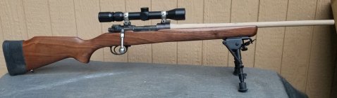

In Sept 2021 I built a 260 Rem rifle throated out to 3.0" OAL on a 1903 Turkish action.
It shot a 1/2" (3) shot group to sight in, and shot a deer in Oct 2021.
