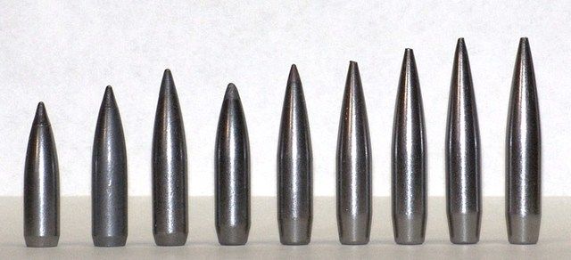

7MM Lineup:
120 BT - 140 BT - 150 BT - 160 Sierra - 162 Amax - 168 VLD - 180 Hybrid - 183 SMK - 195 Berger:
