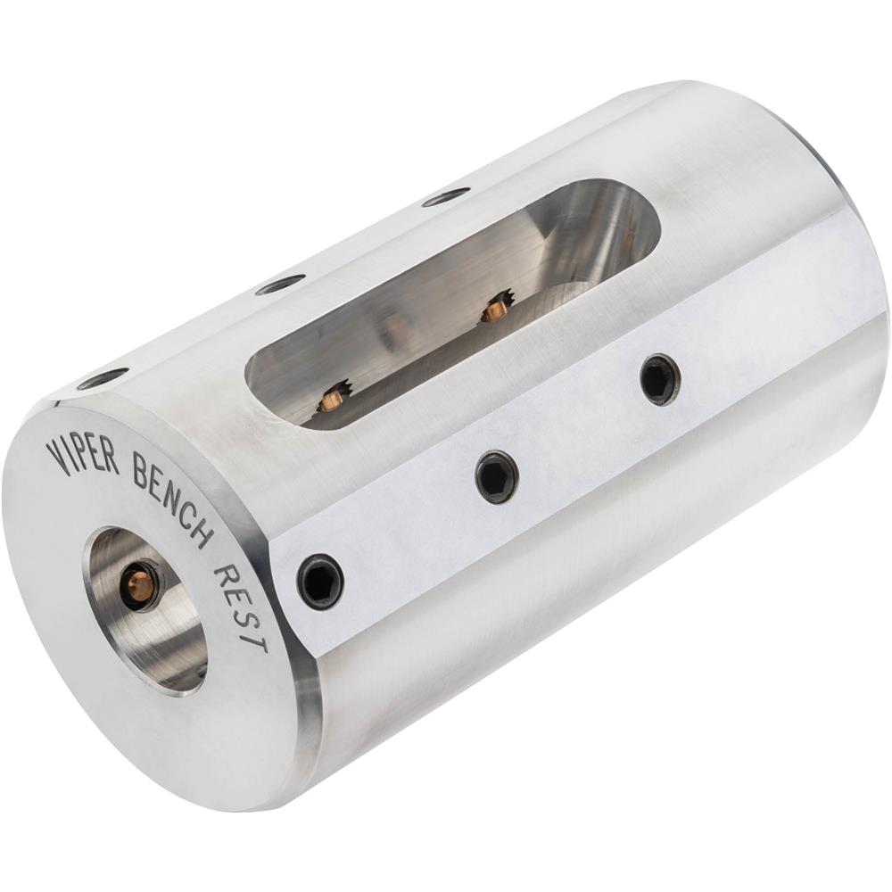

I have one, the Viper. The problem is with the receiver attached, and the recoil lug built into the receiver on the Howa it don't fit. This is what I have, and normally what I would use.

I have extensions, like Aaron just posted. I use those but if I have to I’ll use my Viper, it works as advertised but I don’t like indicating and setting up in it. It’s a last resort thing.
