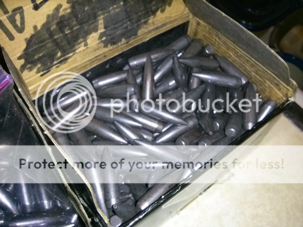

Typical moly coating with dry moly dust:
My wet moly:
ypur upper pic of moly bullets..is abnormal, in my opinion. my dry, peened moly bullets look more like your lower pic.
so something i snot correct in your old process...

I have seen Hornady factory moly bullets that looks very similar to the top one.
BTW, MINE never looked that crappy when I did dry moly... HAHAHA!!!
I actually got these bullets from a guy on the forum and I recoated them with my process.
I NEVER NEVER NEVER got a finish like the wet when doing the dry.... and its so fast and easy. I need to make my video and put it on Youtube.
