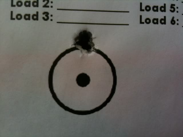

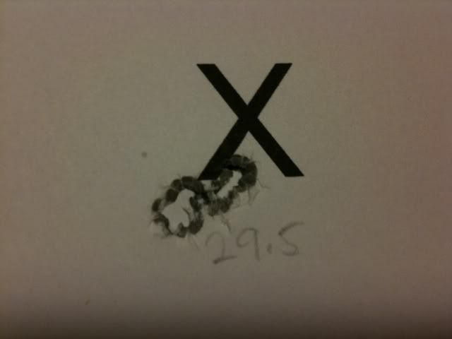

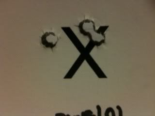

I could be way off base, and I am some what a noob to this, but I'll take a stab at it anyway. (no problems if I get comments, suggestions, or just plain say I'm a dumb a ;D ;D)
When I shoot for groups for load development, fun, or what ever, I seem to notice, when the wind is 'dead calm', those fliers show up.
I've shot my best groups when I have had 5-10 MPH 3 o'clock or 9 o'clock winds. On those 'dead calm' days, or those days of very light wind from 12 or 6, I don't do so great.
I think it is because it is much easier to feel, and see, condition changes when they are more prevalent, than on those days when the air movement is so slight that it is almost imperceptible.
Groups with moderate to heavy full value wind.
Groups with light to calm tail wind.
Could it really be wind is your friend? I don't know... I'm not good enough. yet. :)

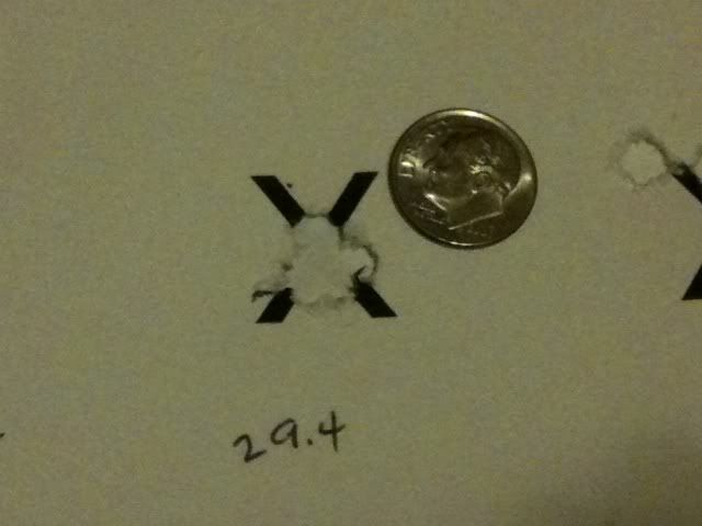

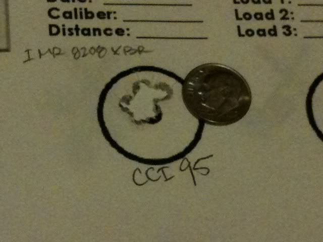

First, those are fine looking groups. And, if you can't shoot tight three shot groups, to start with, you aren't going to shoot tight five shoot groups, guaranteed.
For that occasional flyer, look to your front bag set up, chances are your front bag is too tight.
Had the same problem myself. I was putting bullets through the same hole, then a flyer out of nowhere. As soon as I fluffed up my front bag and didn't over tighten it [I did remove horizontal movement through tightening] my flyers went away.
"Sandbag Fill–A front sandbag that is too hard can induce vertical. Personally, I’ve have never had a rifle that will shoot consistently with a rock-hard front sandbag. It always causes vertical or other unexplained shots." ... Speedy Gonzalez
"other unexplained shots" = flyers
One last comment. Forget Velocity. You don't tune with velocity. Work on tuning with ... powder, seating depth, and neck tension [if you have that capability].
When you have your barrel tuned to the point that bullets are going through the same hole or very close to it, using two or three of the components above, then take note [for historical purposes only] of the ancillary or noncontributory measurements of velocity, ES, and SD. Good Luck.
