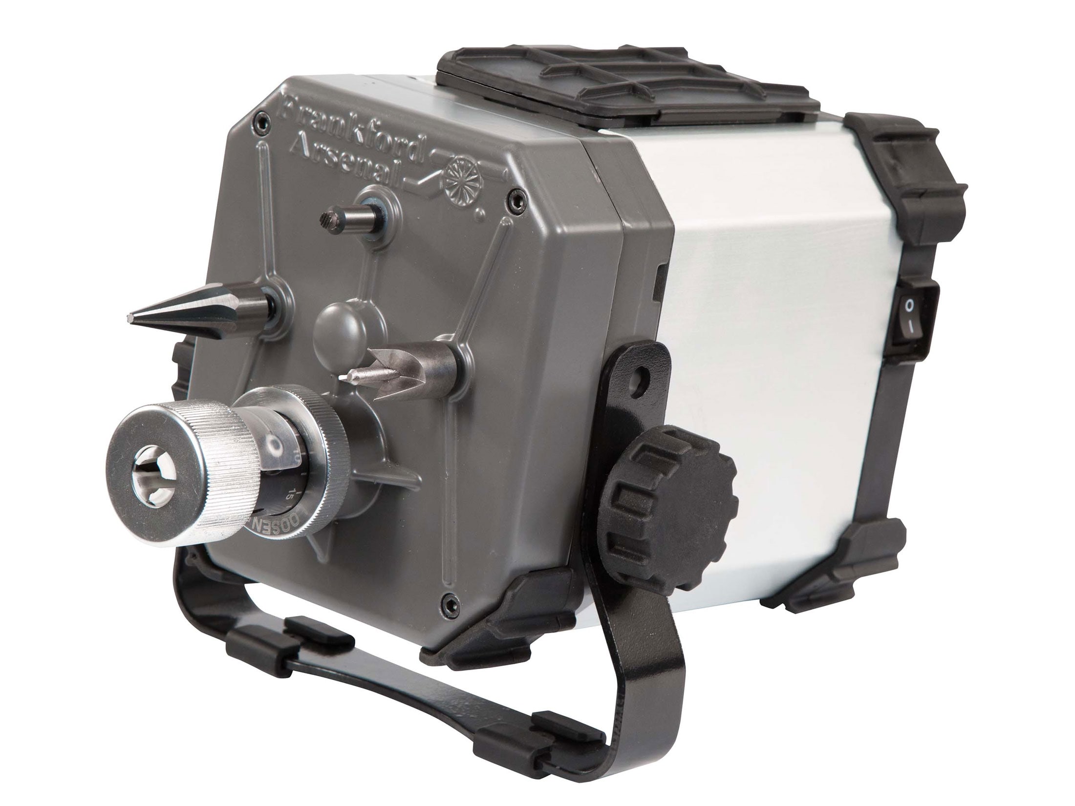

Gonna get the wife to buy this one with her Amazon account.
$119.92 plus tax.
Any problems with this one (costs more)?
Went with the Lyman. Amazon says will be delivered TOMORROW.

With the Lyman, try it with and without the spring behind the collars....decide for yourself which is more accurate and which way cuts a more squared-up case mouth
I use a Dillon 1500 for case forming/ shortening and a Giraud for trimming/chamfering .
I wet tumble so I trim/chamfer after every firing to eliminate any case mouth peening and standardize OAL.
However peening is very minimal on a short wet tumble cycle and OAL doesn't move much per firing. I just do it because I can with minimal effort....1000 Vartarg PD cases after a 15 minute wet tumble takes about 30 minutes to trim/ chamfer.
I find that it's faster to trim on the Giraud, @ 1.5-2.0 seconds per case, than it is to measure OAL with a caliper.
