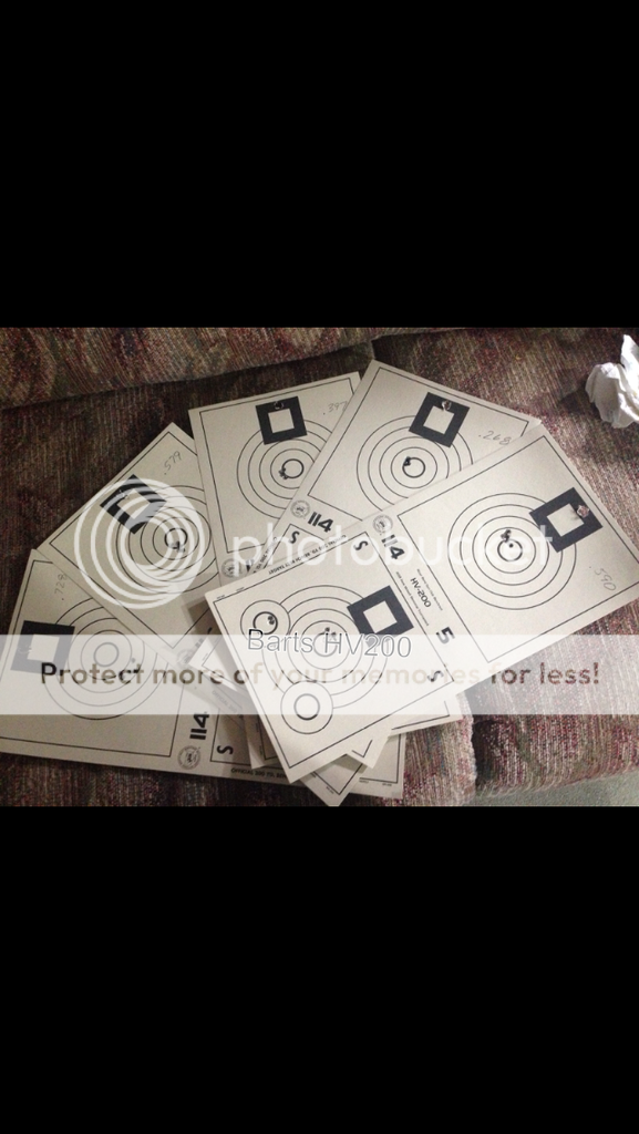

Can you give an example from reading your targets whether you need to increase or decrease powder charge? Things like what is the group doing in order to increase or decrease. Maybe if you have some old targets you could post up to show what to look for and what to do to correct it.
James
James
Here's a great example of starting way too Hot. The first target just splattered. Dropped load .3 second load is still to hot. It popped a out the top and bottom of the group. Dropped another .3 and the gun is looking better but but still off a little. Target 4 dropped .2 it shot great. The fifth target the gun was still shooting but missed a condition.
James
James
Thanks Bart, one more question. How did you know to drop the powder charge instead of increasing? I guess that's where I don't know which way to go is why I ask.
James,
I try to start as hot as I can. That way there's only one way to go.
Thanks and I guess that's simplier than being in the middle and guessing like I would be. I know it's all different format but that's why I like to tune my loads for 600 yards around 80 - 85* that way I'm good for 15* either side of that.

It has to, there no way he could be off by .8, that's damn near a whole node. What amazes me is how completely different I go about it for 1000 yard, compared to short range.
Tom
Tom,

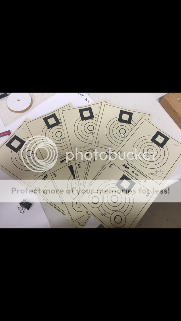

It's not that hard to be way off on a load. I changed the load .8 to finally get on the tune. But while you're trying to find it, you have to remember the load is also changing. The by the 4th target I found it but that's 2 1/2 to 3 hours from when I started. So there was probably a 20 degree temperature change and humidity probably dropped 25%!
Here's an example of staying on the load. These are 5 groups with 10 shots in each at 200 yards.

Bart, That settles it. I'm gonna buy a bunch of your bullets! dedogs
