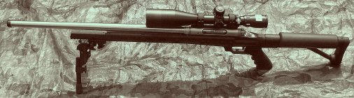

All my customs are on chassis stocks. I call them my LEGO rifles,
and shoot bench rest match's with em'......All my builds have been
on MDT's since that company started., and most everything else
stock wise, I have been machining in house......Avatar is me doing
v-block blanks. and one of my custom 3" drop rider's. Also an
original first make MDT HS-3 with one of my bipod spigot's based
on a Savage PTA. Woodchucks hate this thing......
