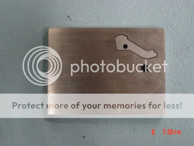

A blade ejector is not worth an extra $300. If you really thought it were necessary you could easily add it to your rocker bolt release like an old L46 Sako. By the way, what does the mouserfeld extractor look like?
The TG ejector on the kelbly actions are real popular and work very well. Little different than a springfield as its built into the bolt release. No tuning required but slings em off the table when runnin and gunnin fast
Dusty,
I had a L46 Sako in 222. It did not have the combo rocker bolt release ejector. I had one wire EDM, but left the short blade off the right hand side. You can see in the photo. I wanted to remone them by hand. I had a factory one borrowed to dimension and left about .125 of the blade off.
