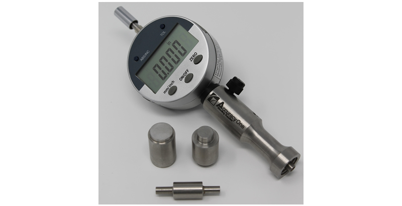

If the primer pockets haven't been uniformed to remove the radius where the sides meet the bottom, the primer sides will try to fold around the radius. This can hold the anvil off the floor of the pocket and cause ignition issues...everything from erratic ignition to misfires. It can be a fake out because it feels like you're using adequate pressure...but the pressure is the primer sides rolling inward and not the anvil seating.
Uniform the pockets and use a seater that lets you feel the anvil seating. Forget any sort of depth measurement lash up.
Good shootin' :) -Al
Al, I think you and I agree on almost everything. In this case I will give you some of my experiences. I uniformed pockets forever, just because. Until I got lazy one year. That year I also decided to test this primer seating depth stuff. I had a real good gun, in good conditions I would expect 3 shot groups to be in the 1s at 1k often enough. Before I started the primer testing I uniformed the pockets to make sure the test would have less variables. During testing and even after going back to seating by feel that rifle never shot a 1 again. Sharing this with some of my friends at Deep Creek many of us decided to try not uniforming pockets. This was maybe 4 years ago? Well none of have gone back and some personal best have been had. Somewhat anecdotal but most of this stuff is results based. I know I will never uniform a pocket again. I actually think that little crimp at the bottom may be a good thing. We also stopped cleaning the pockets too, lol. I stopped cleaning the hunting gun stuff and the accuracy was so good I stopped in the bench guns and saw nothing fall off. What can I say?

And, no matter what you or I say, there are going to be masses of users here that will continue to get all gadgetry infatuated and will insist on playing with their depth below flush settings rather than just seating by feel and making sure, via primer pocket uniformers that the primer is below flush, in spec., somewhere. Some of those might get lucky and bottom just the right amount. Many, in their quest for "the number" will end up with primers not seated deep enough, or crushed in too deep.
Danny
Alex , what about inconsistent depth. Say .119 to .121? This raises the primer in relation to case head. Although measured in microseconds in lock time. I'm assuming from your previous comment that neither depth or curl have changed your opinions. Or are you sorting ?

I will give you an example. The last matches I shot at DC before moving was with my blue gun. During tuning with 3 shot groups at 1k, I never left the range without shooting a zero or a one. Or sometimes multiple zeros and ones. Of course there were bigger groups, but I never went home with a best in the 2s. It was one of the best rifles I owned. The first match I shot, it went back to back, 1.5 and 1.6. We dont track the individual match aggs for records but I think second best is high 2s or so. So to say that gun shot was an understatement. That lot of primers had a height variation of .008". I didnt sort them, I didnt uniform or clean the pockets, I just bottomed them out. I worried about the tune.

Alex, I have to tell on myself, a bit. Forever, I've not uniformed primer pockets until after the first firing as I believe the pocket takes a 'seat' that first hit. Then I just run a carbide uniformer in and use that to clean the pockets after. I made some new brass last season (30BR Lapua) and for some reason, never uniformed after that first firing. I seat with an old Lee round primer seater and the primers felt fine. Out of the blue, I started having an occasional misfire with Fed205M's, which I've used forever. I changed primer lots with no luck. Tossed in some WSR's and had the same issue intermittently. I finally noticed that the face of my uniformer wasn't flat against the case head when cleaning the pockets....light bulb goes on albeit dimly. :oops:
I power uniformed the pockets and took a bunch out of the radius. Primers now had that old familiar bit if 'squish' when the anvil preloaded. No more FTF's.
When I made some new Lapua 30BR brass for this season (new barrel), I uniformed as part of the case prep. I was surprised how much radius there was in there.
Maybe brass dependent???

I've seen the bottom of the pockets push out after 2 to 3 firings as well. Not talking about loose pockets. Talking about the brass taking its set....so to speak. Uniformer in and boom fresh brass removed from bottom. Shows up around perimeter 1st.

That's my experience. Nearly every time on every case I ever load, I am removing brass from the bottom of the pocket. I suppose if one doesn't want to do that, they'd darn well better hope that they don't run out of room to be able to seat them flush, or just below, OR they can just crush them below flush if one is so inclined. There are those brand new, unfired cases that my uniformer has removed brass from the primer pocket bottom.

Thats also because I dont enjoy reloading anymore. Im not saying that uniforming is a bad thing if you want to do it. And in some cases like Al's I guess it can fix a problem. The last ppc I chambered for the tack driver gun, I even did a no turn! o_O

Alex, nobody was more surprised than me when that 'fixed' the issue. :eek:
