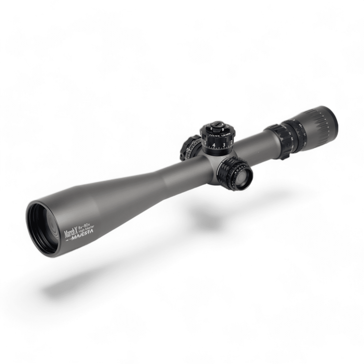

And what you don't want, when the sun is glaring at Orangeburg. Take any
camera lens and stop down the aperture when it gets too bright outside to take
a certain pic, your looking for. A rifle scope is no different. The problem with a
rifle scope is, you can't close down the aperture, because it's fixed. The one
piece of gear that is available is a modifier disc. In some cases, that's even too
big.......I've since accumulated a few discs for the High Master March to make a
series of varying sized inserts. Here is one I knocked down to 32mm and has
worked the best with extreme sunlight over our snow pack. I do plan on making
an even smaller one. Maybe a 20mm disc ??

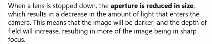

I think Carl @glockaholic sells diaphragm-base modifier disks. These can be infinitely adjusted to the aperture size that you want. The method here for every 50% reduction in aperture size, you are doubling the F-number. Since there is a square in the calculation of the area of the aperture, you have to do this properly. For instance, for a 56mm lens, reducing the aperture by 50% means going down from 3.141592 X 28 squared or 2,463 mm2 to 1231mm2 or 3=19.8 mm radius or 39.6mm diameter, call it 40mm for half the light. The next step down would be 28mm for another 50% of light. And so on. Do check my math before you start drilling.

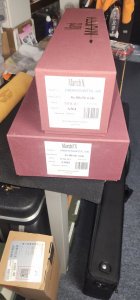

I thought they changed the packaging. Must be a recent improvement. My first on top. Most recent on bottom.
