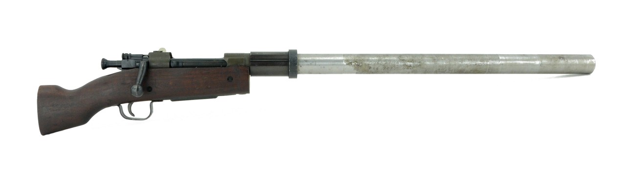

If that came with a set of barrels that would work. My original work was with the US Navy's electric railgun so I never thought that was another name for them.

Looks a little antiquated (many actions available to day are stiffer and have a faster lock time) to me, like was posted maybe a good benchrest rail gun and have one of the best barrel makers do a set of barrels. Did you talk to Frank green about barrels?
