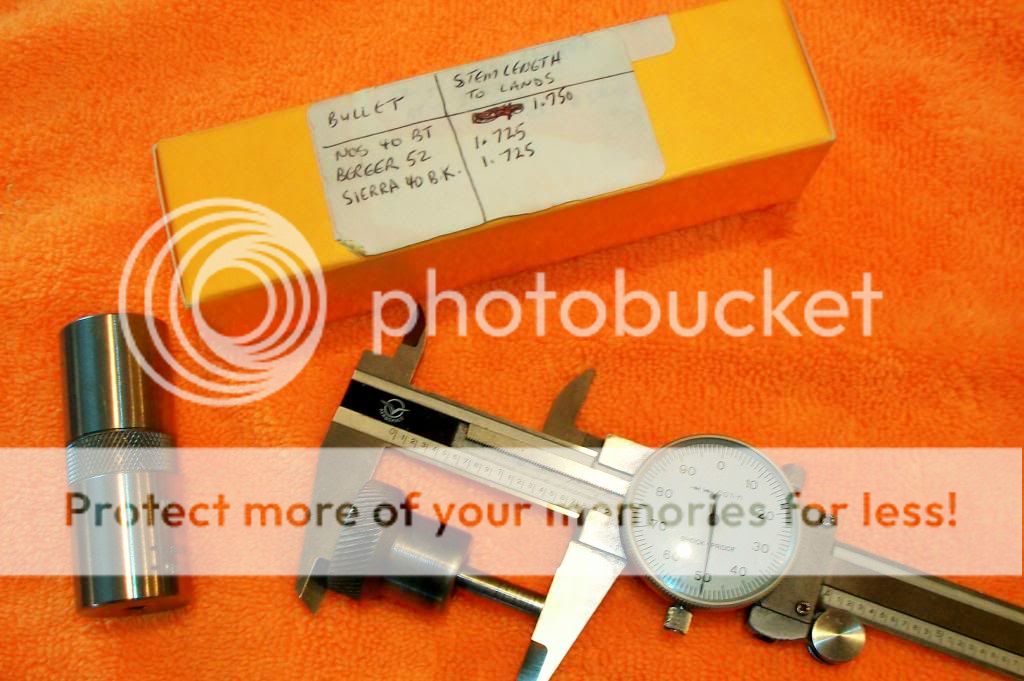

For a seater, I strongly suggest a standard, non-micrometer top, non-stainless Wilson seater. With the thread pitch on the Wilson seaters, each full rotation changes the seating depth by .040, which makes it a snap to quickly change your seating depth. Just measure the overall length of the seating stem/cap assy. after you find the 'just touching' dimension, record it and then you always have a reference point from where to go. You'll need a small arbor press for the Wilson seater. The K&M http://www.kmshooting.com/catalog/arbor-press/arbor-press.htmlld or Bald Eagle
http://www.grizzly.com/products/Mini-Arbor-Press/BE1001 are both great.
Want to change the seating depth .010?. Look at the stem from the top, loosen the screw, turn the stem 90 degrees and you're there. After a few times you'll find you'll not be off by more than .002-.003 when checked with a caliper.

The easiest way to adjust a Wilson die without micrometer top is to measure the overall length of the stem and cap, then move the stem, tighten, and check again with calipers. That is the easiest and most accurate way to do it.
'Morning, Erik. :)
I believe I'd addressed that issue with this quote from my post:
"Just measure the overall length of the seating stem/cap assy. after you find the 'just touching' dimension, record it and then you always have a reference point from where to go."
In any case, a pic. is worth a thousand words...so here's what we're both refering to:
AlNyhus said:
'Morning, Erik. :)
+1 on this method
