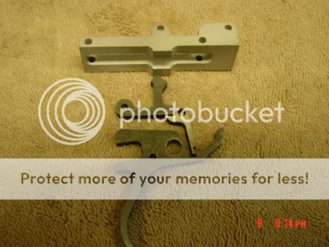

This is my custom trigger that I did for the 452 CZ. It is wire EDM

Beautiful looking parts. Melonite is done above 580C and it would take over an hour. Never did Melonite myself but you have to diffuse carbon or nitrogen into the steel. Expensive for small batches and you can get warpage. TiN is a vapor or sputtered coating and can be applied at quick and at low temperatures.
