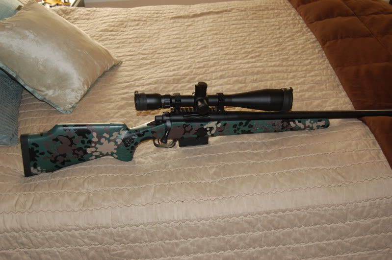

Here is my 6br repeater. I added a spacer to the front of the AI mag and tweaked the feed lips a little. Feeding is fantastic now.

If you like I can pull the magazine apart and take some better photos of the mods that I did to mine. I shot a tactical match yesterday which was 80 or so rounds and it fed every one perfectly. I realised that being able to fit 6 or7 rounds is a necessity for some of the snap shooting where you have 2 shots in a 10 second exposure. There's no time to change a mag during the third exposure and I missed some points because of it.

John, I don't have any pics handy at the moment. I simply trimmed the front of the mag follower and epoxied a 1/4" aluminum spacer in the front of the mag. even after doing this, the mag wasn't running 100%. I had to tweak the feedlips a little to allow the case to sit higher in the mag. This alleviated the issue, but took 30 minutes or so of trial and error to get it right.
