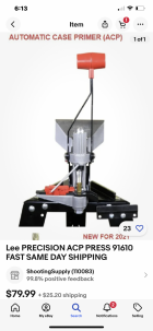

If you watch the video, the Lee ACP doesn't use a shell holder and
won't have the difference in rim thickness as a problem.
If you use the Lee and a primer pocket uniformer, would seem to
fix most of the problems with slack or different primer pocket depths,
since both are indexing off the base of the case and not the rim. ( thickness )
And here it is.
