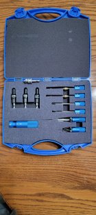

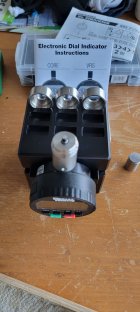

Out of my CPS: +/-0.001" is the very best I have been able to achieve using Lapua brass with pockets cut at 0.1315" depth using 21st Century pocket uniformer and using Primal Rights PrimeWhere and AccuracyOne w/ 0.0001" Mitutoyo Absolute Digimatic Indicator. My results align with Bryan's test results. Unless we are both testing w/ CPS units that have internal tolerance issues, I have to assume that people getting better results are using measuring instruments of lower accuracy/resolution or they aren't checking every single primer they seat. If someone is using of equal or greater quality indicators and getting better results than I am showing, please share your results. Attached are photos of my equipment used to cut, measure & seat primers. Primer pocket variation on this batch of 50 (LRP) is +/-0.0002". I would love nothing more than to have my seated primers measure within a +/-0.0005" tolerance. I will post my data log of the measured pockets and primers soon, once I locate them in my files.
