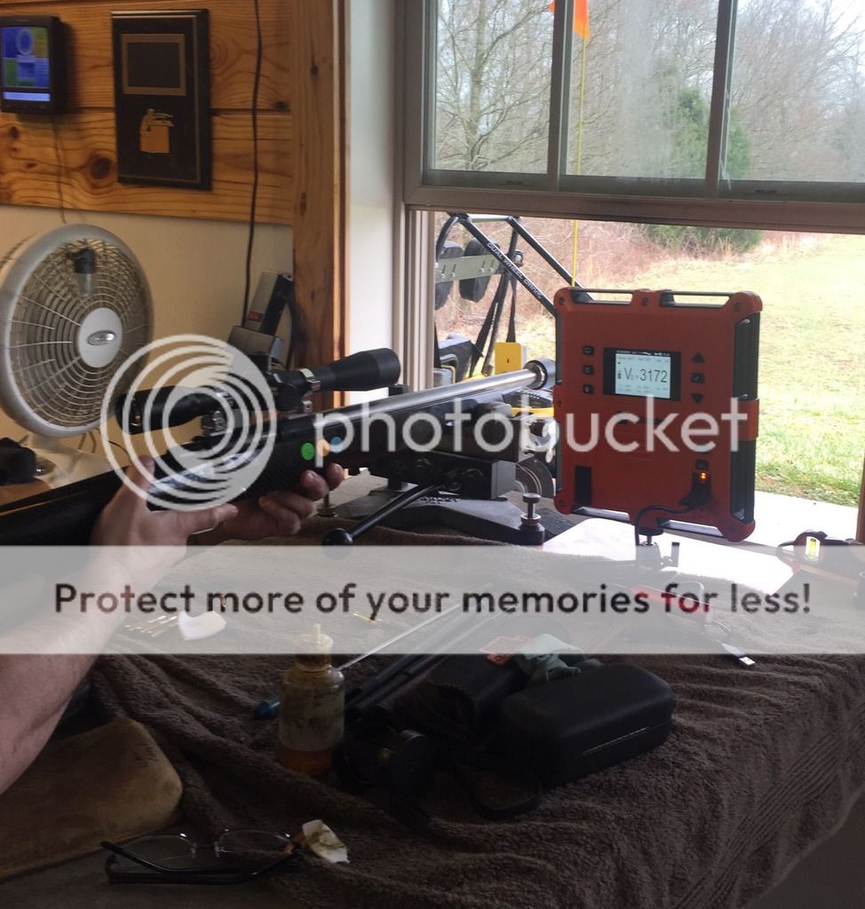

I've got it easier than most! Mine stays right there on the bench. Just push a button.
Bart -
That sounds and looks easier then attaching a Magnetospeed, and definitely faster then setting up conventional eye sensor types, and no wires to boot. Nice setup..... thanks for sharing !.!.!
