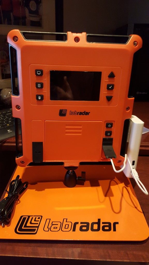

And you will need a bench with a lot of surface area to position the LR so that it works properly. That was my view of it once I received mine and decided it wasn't for me. The MS just seems to be easier to setup and takes up less space.
You also don't need to lug around a tripod to mount the Magnetospeed.
Here's what I use for my LabRadar. I can use it on the bench or when proneCapture.JPG
Wouldn't dispute your personal preferences or the benches you may use, but . . .
. . . I haven't ever found the unit to *take up* a lot of bench space. With a c-clamp, the base can be hung off the corner of the bench so that the unit itself blocks ~6" of view . . . only 1/4 of the base remaining on the bench. Other than that, "stuff" that doesn't need a forward view can be placed on the base just as easily as on the bench.
