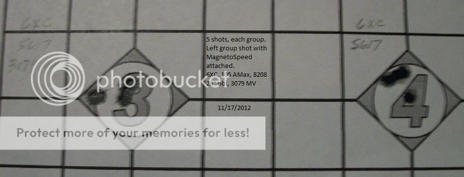

I wanted to see how attaching the unit to my barrel would affect POI and group size, so I did this test today. On the left group there are two shots apart from the three others and one with the right group. Not sure, but I think my rifle is trying to tell me it has a carbon ring.
Anyway, I have heard POI shifts up but mine appears to have a slight shift downward. And groups appear to be nearly the same.
BTW, bayo was attached to the bottom of the barrel, just behind the muzzle brake. Also, groups were shot from a concrete bench using a cheap pivot bipod and a rear bag.
Erik, what do you see in the groups? Do you think I may have a carbon ring? I'm thinking there are a total of three flyers in the two groups caused by a carbon ring.
I ceramic coated the bore with hBN before the first bullet went down the tube, and shoot hBN coated bullets. And since then, just dry patches every 20 to 40 rounds. The bore has never seen any chemicals nor any kind of brushes except for a bronze brush briefly in the throat area (in case of carbon ring). Round count is currently 573.
