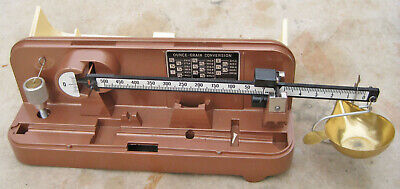

I have read about the M-5's and after this thread was brought back up I looked at Fleabay last night and found a Lyman in new condition for $ 108.00 . And grabbed it . Using the zoom on all pictures I could not find one scratch on it . Suprised someone had it on the Buy Now" for $ 108.00 . All others in ok shape were hitting close to $ 200.00
This is the one I bought .
Looks to me as if you have a bargain there - I have seen several M5's of that age/colour where the body paint flakes off badly, not that it would effect performance. The auxiliary weight looks like it's taken a knock. The centre of the pan looks more worn than I would have though judging by the very little evidence of wear on the beam notches. (Might not be original) Get a set of basic grain checkweights for peace of mind and pass it on to your grandson when you've done with it.
