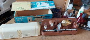

I just bought a clean used m5 for a friend off ebay a week ago. 80 bucks delivered in 4 days. I adjusted all the hangars, cleaned it, straightened the .1gr poise, pencil lubed the knife edges ( even and clean), glued on a needle and adjusted the pan shot for 30g check weights with a cut down 35mm plastic canister as the replacement pan. (easier for throwing).
Just with above process it repeats the to the 10th of a 10th and reacts to a single grain of varget. The M5 typically dosent need much but a few tweaks which anyone can do. I always 'zero' my scale with the closest check weight mix i have to the powder weight I will be weighing. Pretty damm simple and fool proof.
