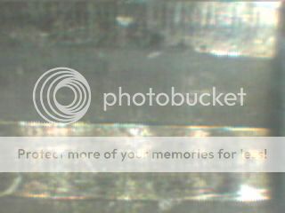

Works fine and easy. Now to learn how to interpret what I'm seeing! Like looking at aerial photography, it's hard to decide what's a pit and what's a bump.
I assume there are pits on the left, and the "worm" on the right is debris (lint from a patch?) or fouling.

This is a Rem XR-100 chamber, leade to the left, neck on the right. What the heck is that blob at the end of the chamber? It's not carbon, I don't believe, looks like metal. Also notice what look like pits, one in the big blob, and another in the neck wall. Or are they bumps, not pits?
The second pic is the same chamber, but a different position around the circumference. Notice the nice clean, sharp end of the chamber here. Also the fire cracking on the leade ramp.
Any comments appreciated!
Run a dry patch thru it , see if it moves , mark the outside of scope for ref. Is it a factory barrel , what does your fired brass look like in the aprx vicinity of what looks like a drilled hole ?
Oh, I've been all over it. It's shiny clean, and the blob ain't movin'. I believe it's steel. There are no marks on the necks which correlate, what we see through the scope is well past the end of the necks - a Sinclair chamber length gauge stops at 1.935", the cases are only 1.900" long.
This is a new-to-me gun, I inherited it from my deceased hunting buddy, but have not started loading for it.
Is there a scope base or rear sight above or near the hole ? Is it all factory ? What about the trig hanger on the xp , if the hole is on the bottom .
The blob could be cerrosafe , chamber cast stuff . I'm just guessing unless he shot lead bullets
Change light intensity or Color if you can by inserting opaque Mylar , plastic for the light to reflect off of .
