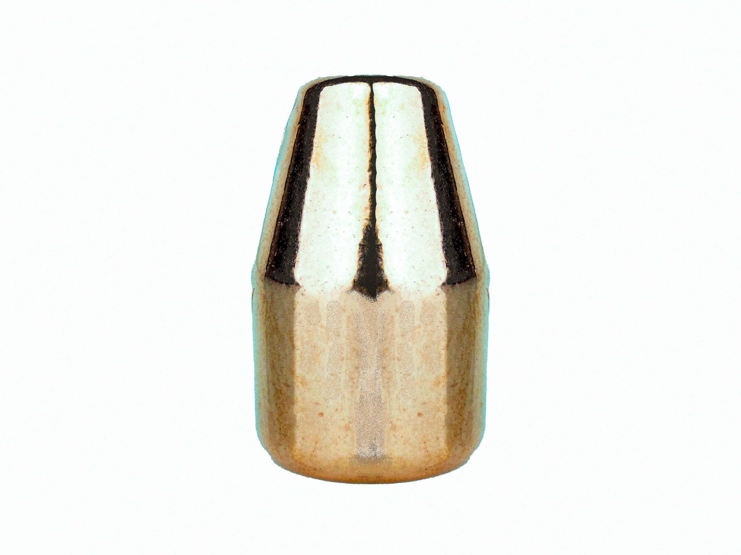

I use Hornady 147 gr rn or hp, with a boattail base, so I dont have to flare the case mouth, or worry about insufficient crimp.
The bullets arent cheap:
147 rn - 0.18 ea
147 hp - 0.29 ea
Pricey, but I will trade money for time and efficiency / ease of operation every time.
I love the 147 gr weight bullets for my subsonic shooting with suppressors, and particularly the Hornady XTP HP with the boat tail. Cost is the single reason I don’t shoot more of them. I did find some Zero 147 HP and they have a “stepped” base to prevent the slight bulge in case wall if not seated precisely. This would happen occasionally when using a myriad of mixed brass accumulated from my years as a Firearms Instructor for my Dept. (The practice ammo was typically whatever was cheapest for the annual contract of 50-60K rounds.)
I have tried many of the cheaper coated, plated, and jacketed straight based bullets and they tend to exhibit the aforementioned occasional “print” on the exterior of the casing.
I am intrigued by the selection of bullets you pictured, so please share with us your source for the boat tailed bullets you are using.
Thank You in advance, Sir.

They are both from Midway.
The hp are XTPs in Hornady boxes. The r n are bulk pack from Hornady by Midway.
I do find using the chamfered / boattail base avoids the case bulge of other bullets.
