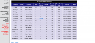

Just spec’d one out on Xcalibers website, you’d be right at 460$

I'm getting $430 for a 26", AR barrel in 223. [PSA: X caliber usually has 20% of sales around many of the holidays.
FYI. It costs $80 to go from 24" to 26".
The same barrel from McGowen is $380.
The website says there is a Black Friday sale still going on.
