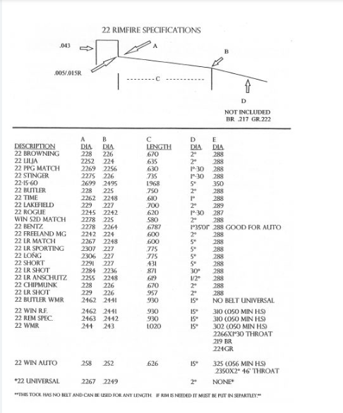

The 52D may not be the most popular chamber in use today, but it's no longer considered to be a match chamber?
For readers looking for comparisons, a number of current and once popular reamer dimensions are shown in the chart below, including the WIN 52D MATCH
